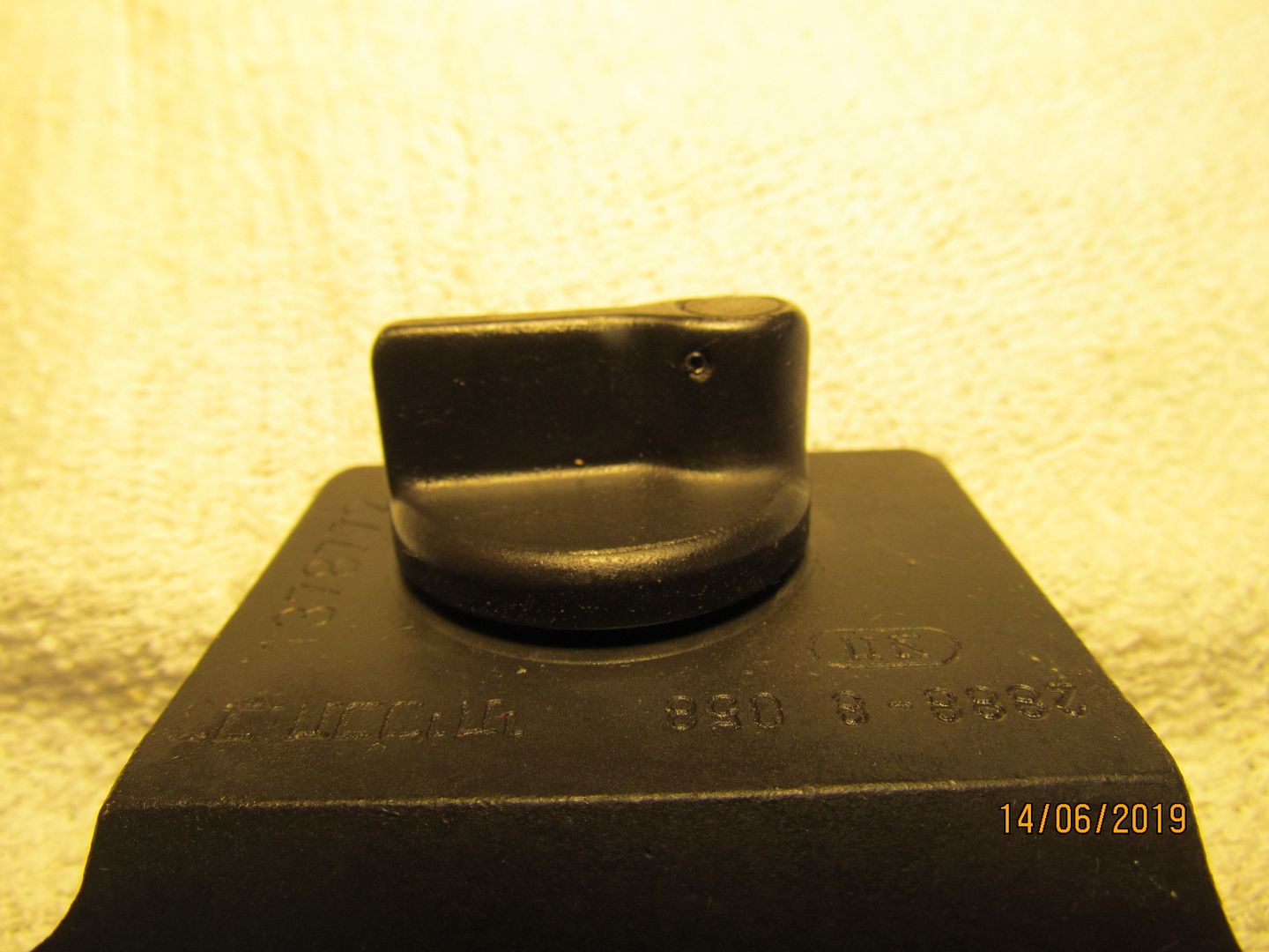

    Quote Originally Posted by nf1e View Post
    I have an M1D and this is much more positive.
    I've had several, but the serations were worn badly. never figured out just what that push button does.. Art L.
  2. #12
    Moderator nf1e's Avatar
    New Preston, CT
    6,265
    Re: One very serious scope mount.
    Quote Originally Posted by The Comet View Post
    If you are talking about the IDF mount, it's not a push button. It appears to be a cover for the plunger detent spring.
    yes, the IDF mount,, that round button compresses, maybe it lifts the unit off the serations for removal... Art L.
  5. #14
    New Preston, CT
    6,265
    Ya got me going now Art. I have 2 of them and didn't know it compresses. I will have to take a closer look when I am in the shop. Thanks for teaching me something new. Today is not a total loss.
    Never could figure out if it comes apart, let me know what you find out.. Art L.
  8. Thanks nf1e, VanHahner thanked for this post
  9. #16
    New Preston, CT
    6,265
    Re: One very serious IDF scope mount.
    Here we go Art.
    After careful examination and disassembly here is what I found. The button, as you call it, is simply a grooved re-tension cap for the spring which establishes the pressure for the ratchet system and is held in place with a tiny pin that rides in the groove. Photos of mount assembled and with spring and cap removed. That is one itty bitty pin. Had a heck of a time finding something to use as a punch to get it apart.
    Was it solid or a roll pin ?
    U.S.M.C. Scout Sniper 67-68
  14. #19
    New Preston, CT
    6,265
    Roll pin.
